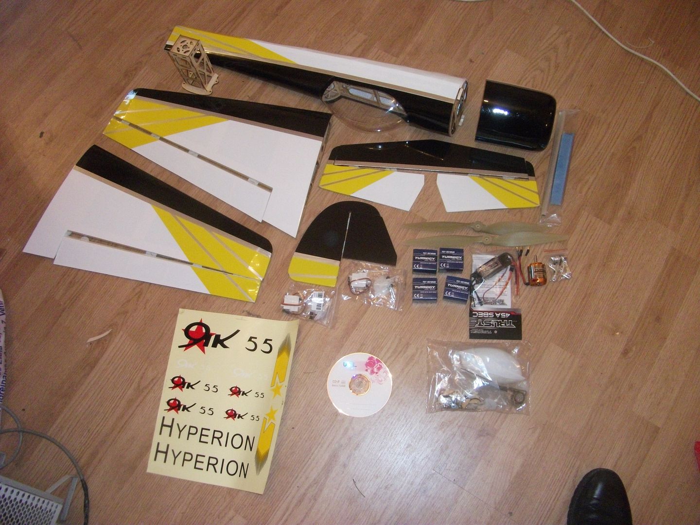

OK photos to follow of what came in the box.

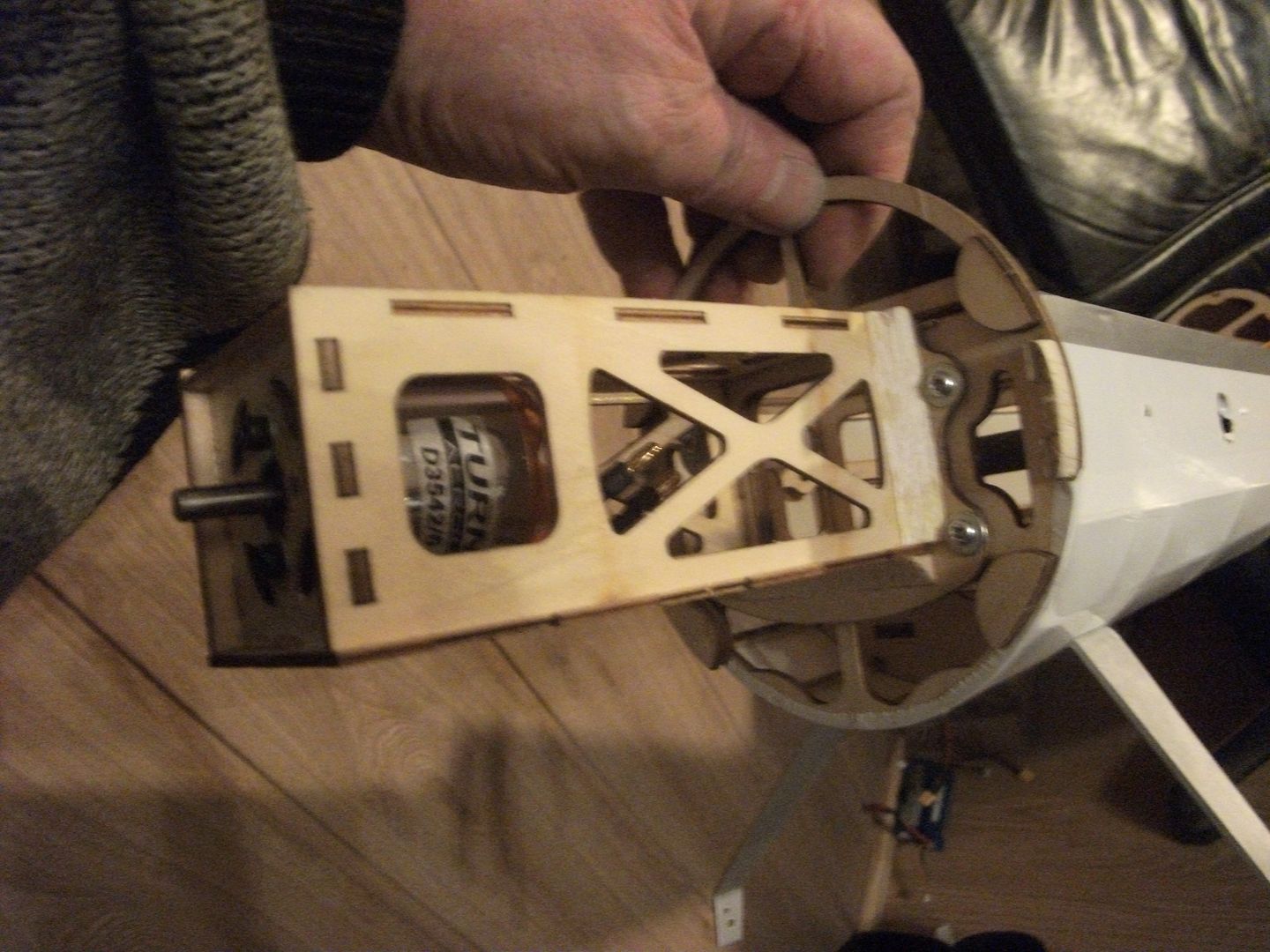

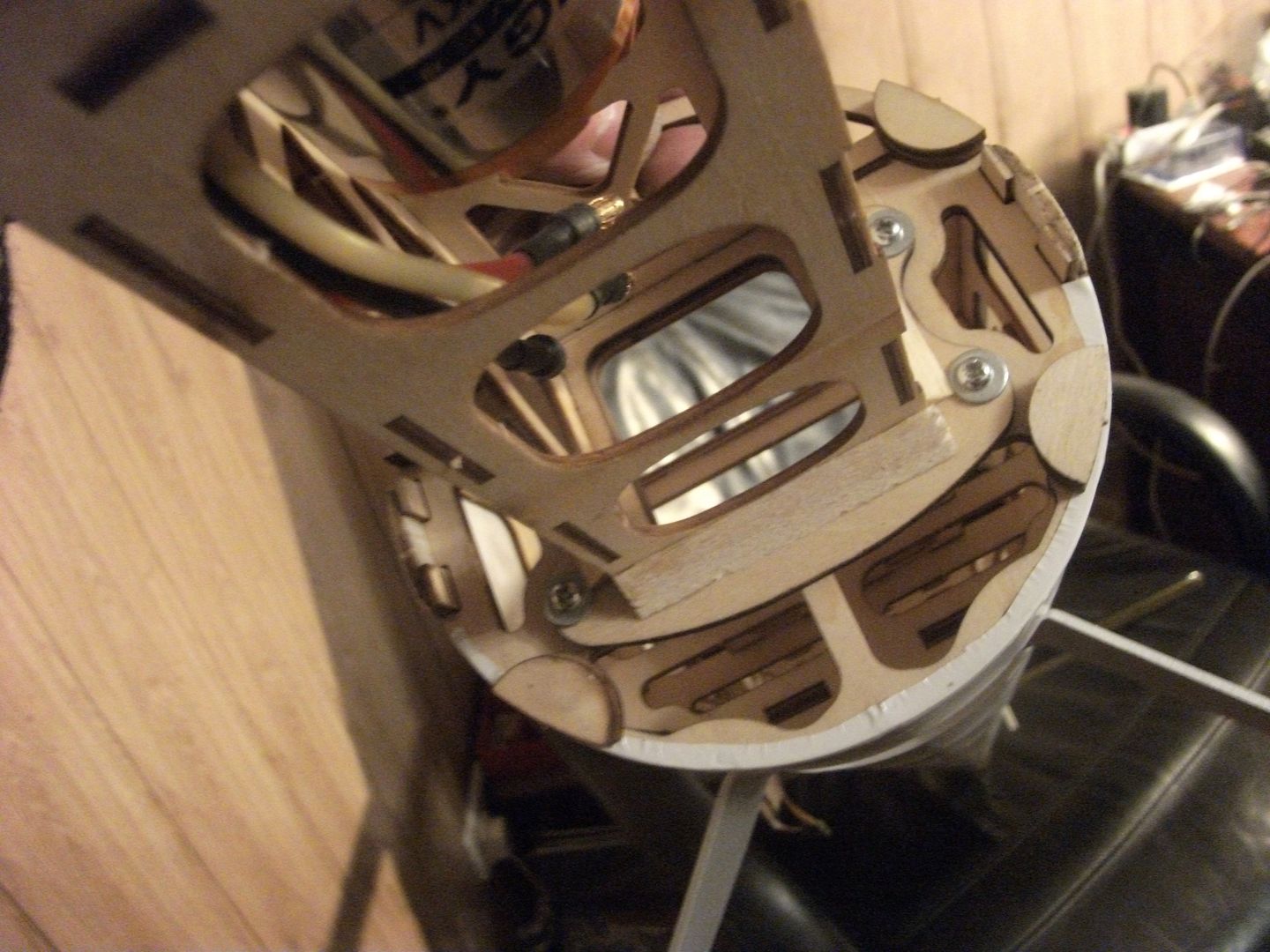

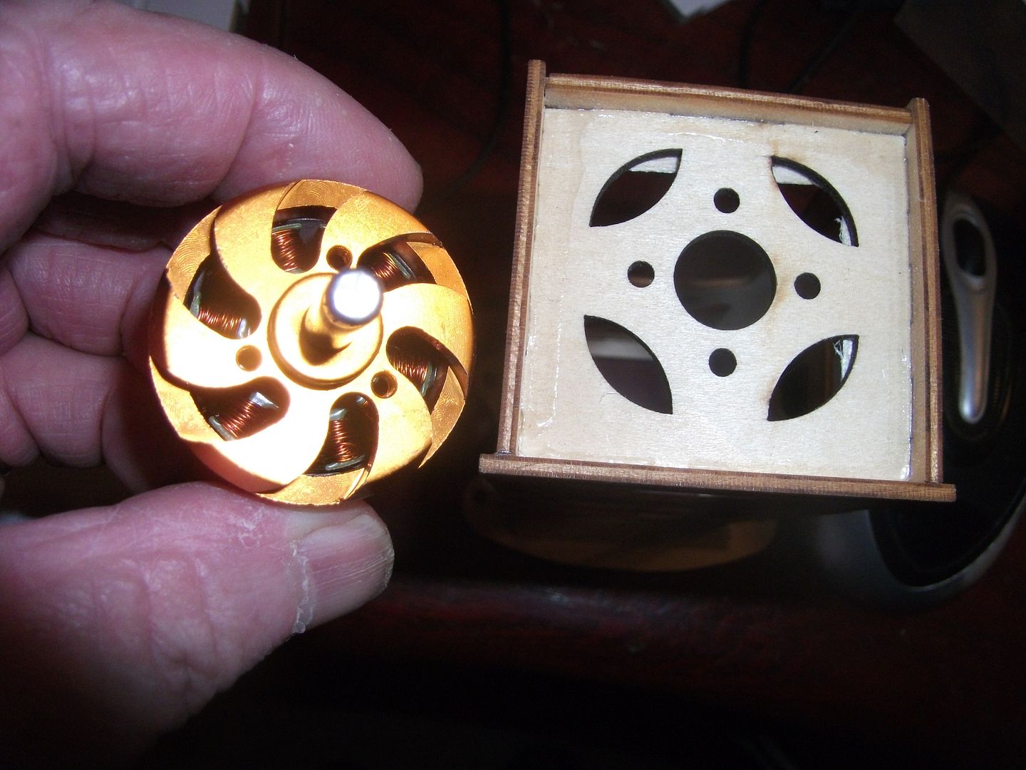

First thing I note - motor has rear X mount but front is a 3 screw prop adaptor face. This does not fit the supplied motor box.
The motor has to be rear mounted.
I have scanned the motor box and will construct own to take the rear X mount motor. It will be shorter than original.

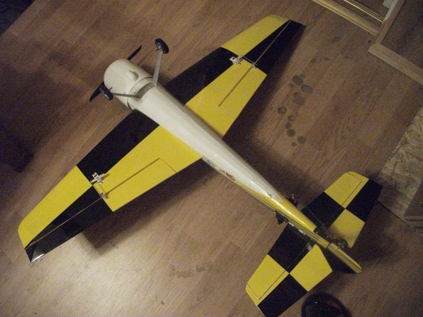

What came out of box is actually initially looking pretty good ...
Covering edges all seem to be down ok ... all seems to e in good condition - no immediate damage evident.
As suspected this is the Hyperion smaller brother of the biggie seen on Youtube.
First I need to make that new motor mount so the 3842 can slip in there ...

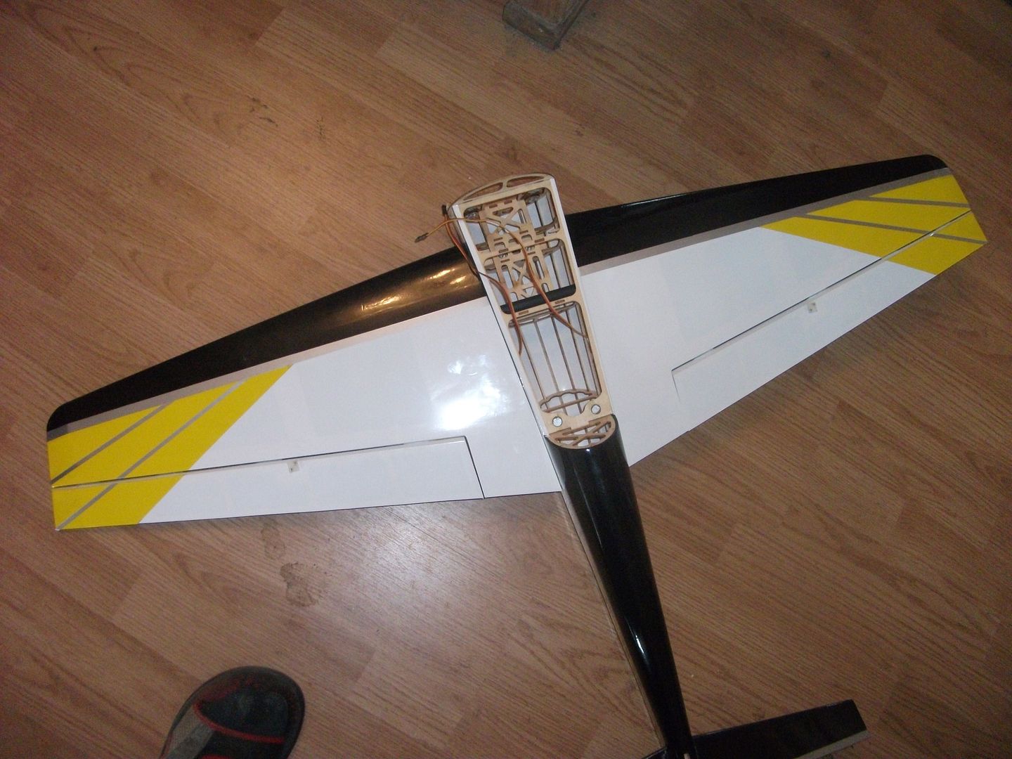

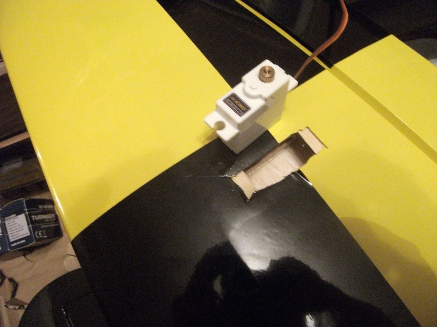

So wings ... and as its an electric job .. I'll go with the suppplied CA hinges .. I'm not a fan of them I admit.
The Hobby King HK15148B servos are too small to the slots, are metal geared ... and I do now want to add extra beams so should do the job ok.
This I will ponder on before going further ...

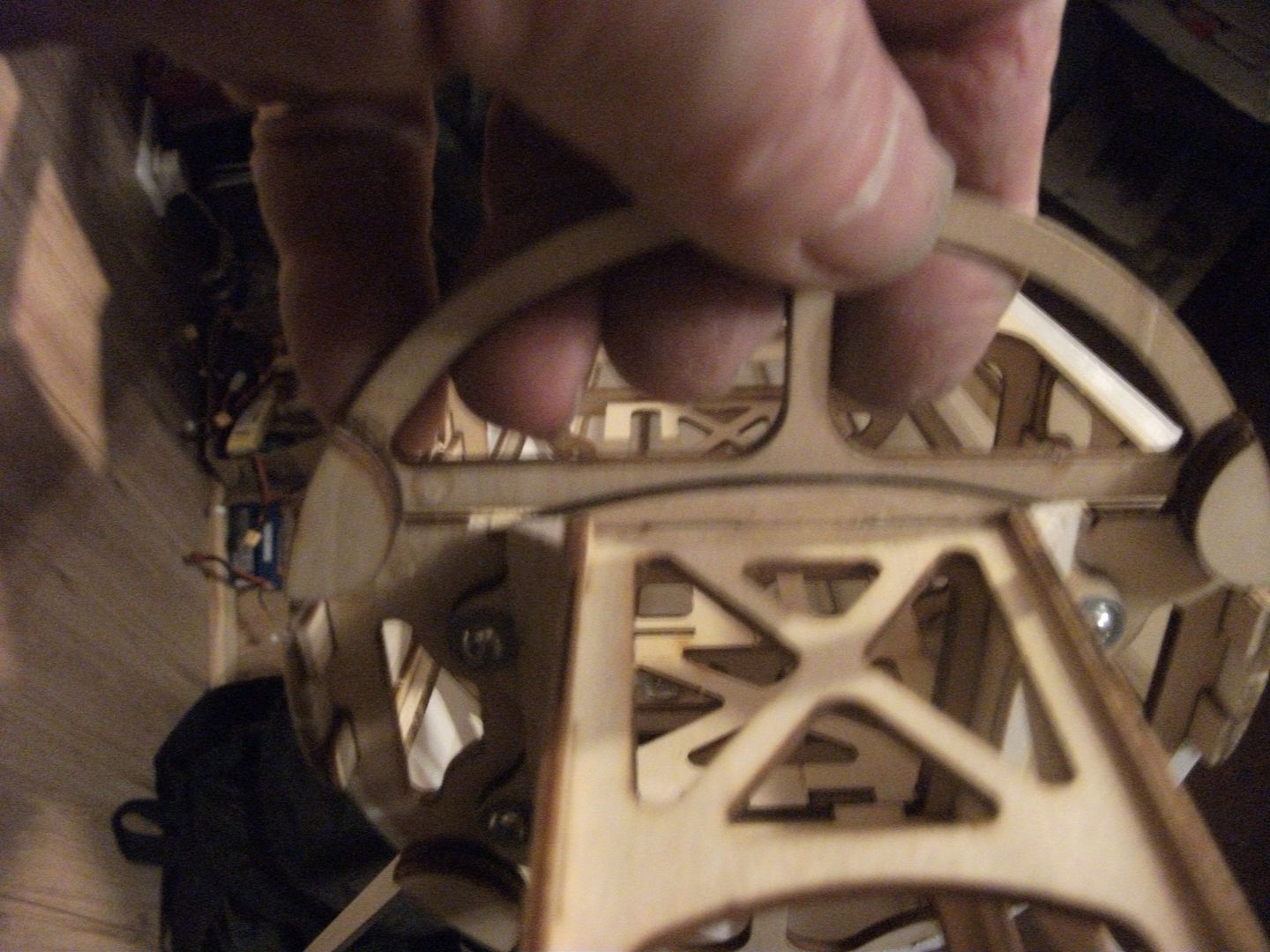

I strengthened the wing seats, battery box and landing gear mounting plate. One day I had a bumpy landing and it broke clean in half behind the wing and on inspection there was no strength there so I repaired it with extra stringers and plates.
All good and flying again.

Where it broke... Note that I had already pro-actively fitted an extra balsa former there but it still wasn't enough.
Repaired

Decided I will stick with servos I have and add small correction plates.
I will also use split servos at rear for elevator, as the Turning 9018MG are a lot smaller / lighter than the designed slot size. This will give me better control.

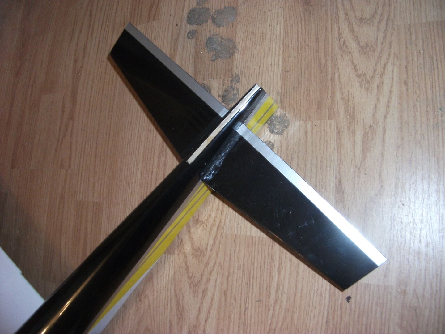

OK ... this is a strange beast ....

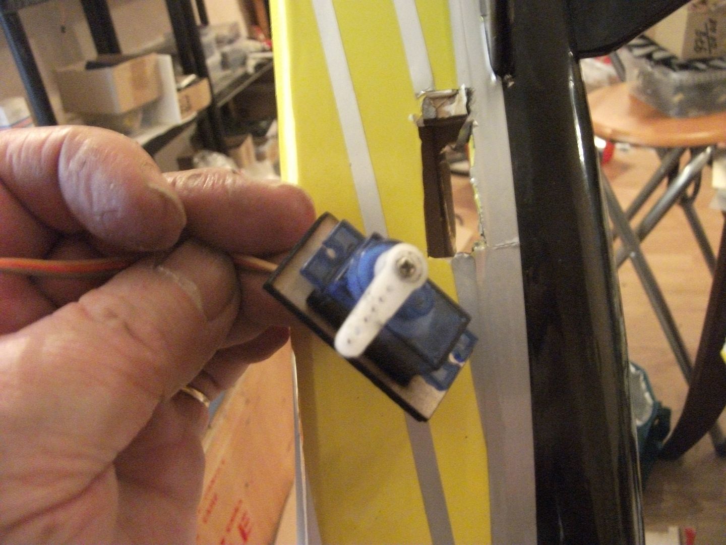

The tail servos slots are strange size if you want to fir recc'd ! So I ended up making ply plates to fit mine :
So ended up with split Tgy Metal gear 9gr on elevators due to lack of depth in fuselage - backs butted up to each other.
And the Turnigy 9018MG on rudder.

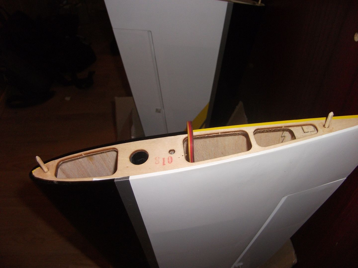

Wing locating pegs not in kit ... so made my own out of bamboo ..
Tail stab in place .. all measure up fine ... glued in place and it's got slight twist ! Luckily only sllight ... but it's there. Not much I can do about it ...
Starting to come together ..

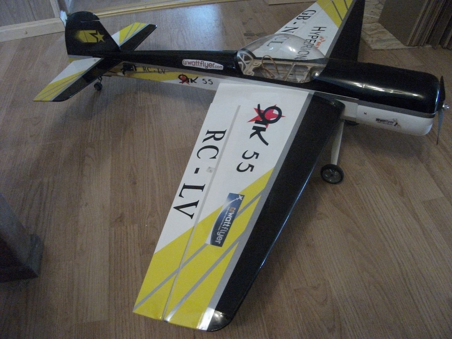

Posts: 12,596

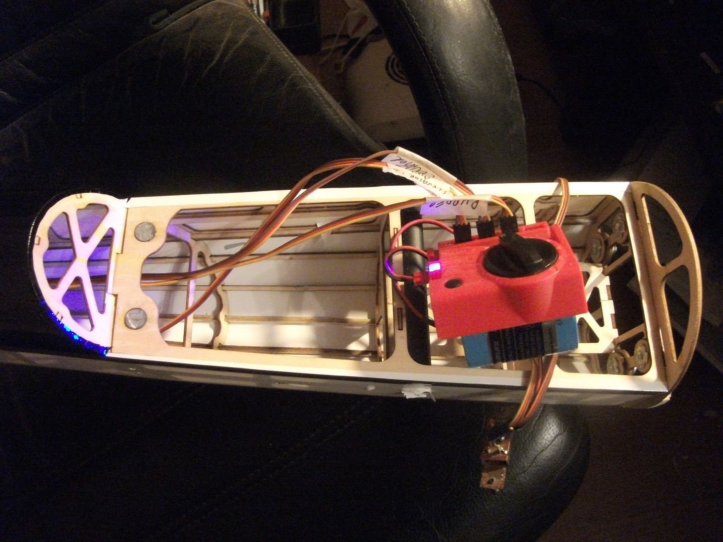

Now the bit I hate .... balancing with Lipo ... fitting control rods ... Rx etc.
Ready for final bits :
And underside is good contrast ..
That's a 10x6 prop on there at moment ... with wheels she can take a 12" ... but I've ordered some 11x7's ... see what they do on that motor.
I can actually build up that U/C block to give another 1/2" actually ... as the plate is set well into the fuselage. Foam block with lite-ply plate would keep it very light.

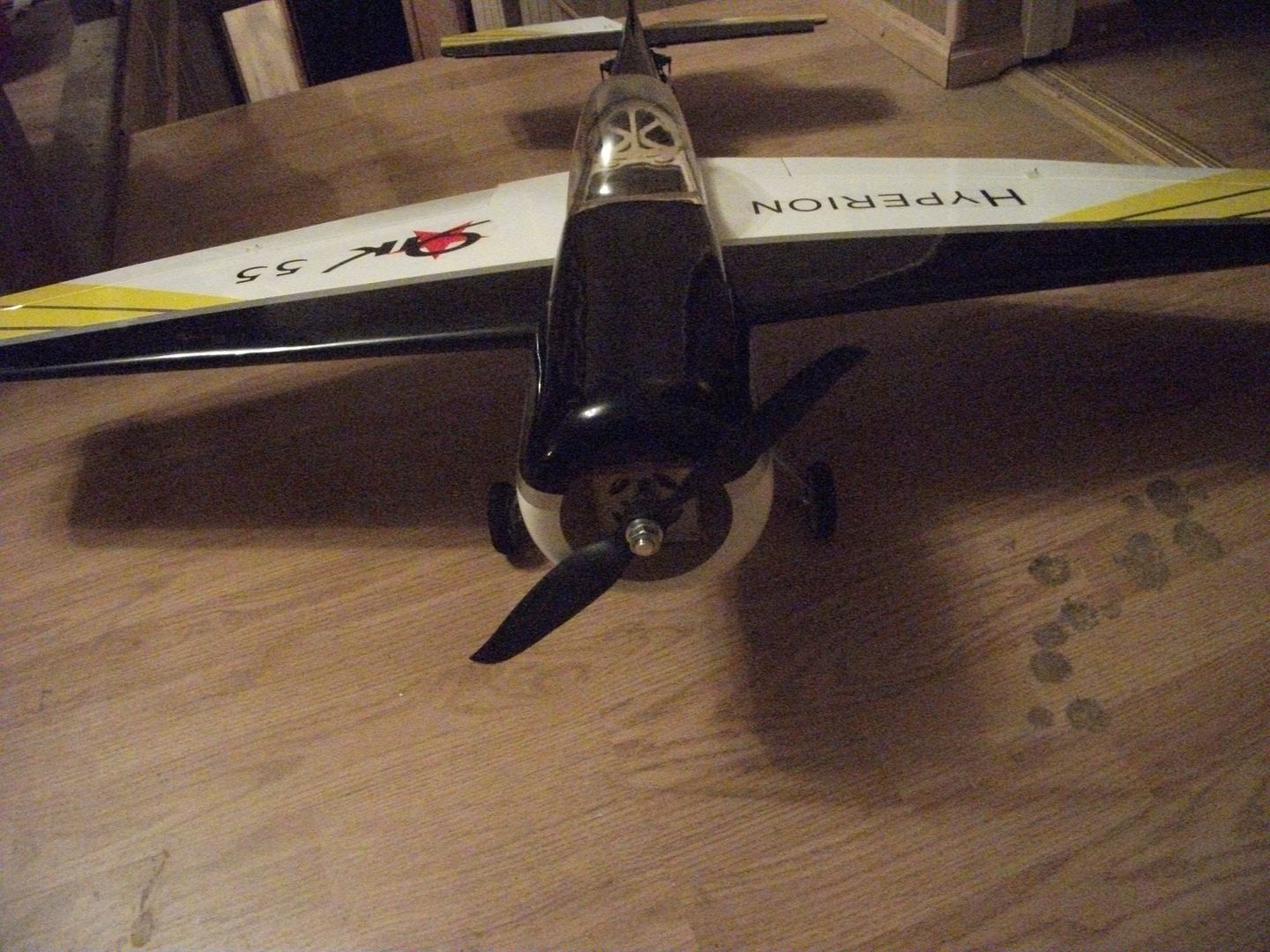

Posts: 12,596
So fitting out :

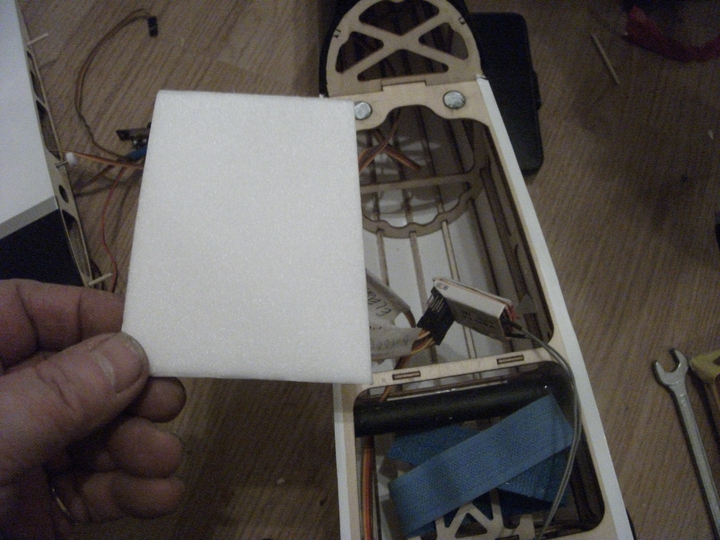

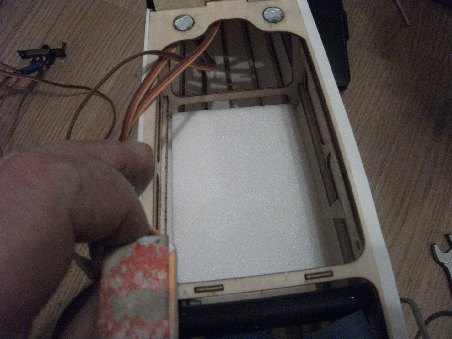

First we need a Rx tray :
That is from 6mm Depron and epoxied onto lower fuselage rails. It also provides a little more stiffening for no weight.
Rx is a 7ch FrSky ....
ESC is a Turnigy Trust 45A with SBEC
Battery tested with : Turnigy 2200 mAh 3S 25C
AUW excluding LiPo : 985gr
AUW including 2200 3S LiPo : 1180gr
Wattmeter results with 10x6 TGS sport prop :
Amps WOT : 25A
Volts WOT : 10.3V (Lipo is at storage level so this figure is low as a result)
Vertical test : She will rise out of hand - but there is not a great margin ... a better charged battery and the 11" prop will sort that.
CoG has come out at 90mm back fromn L/E of wing ... manual states 85mm.

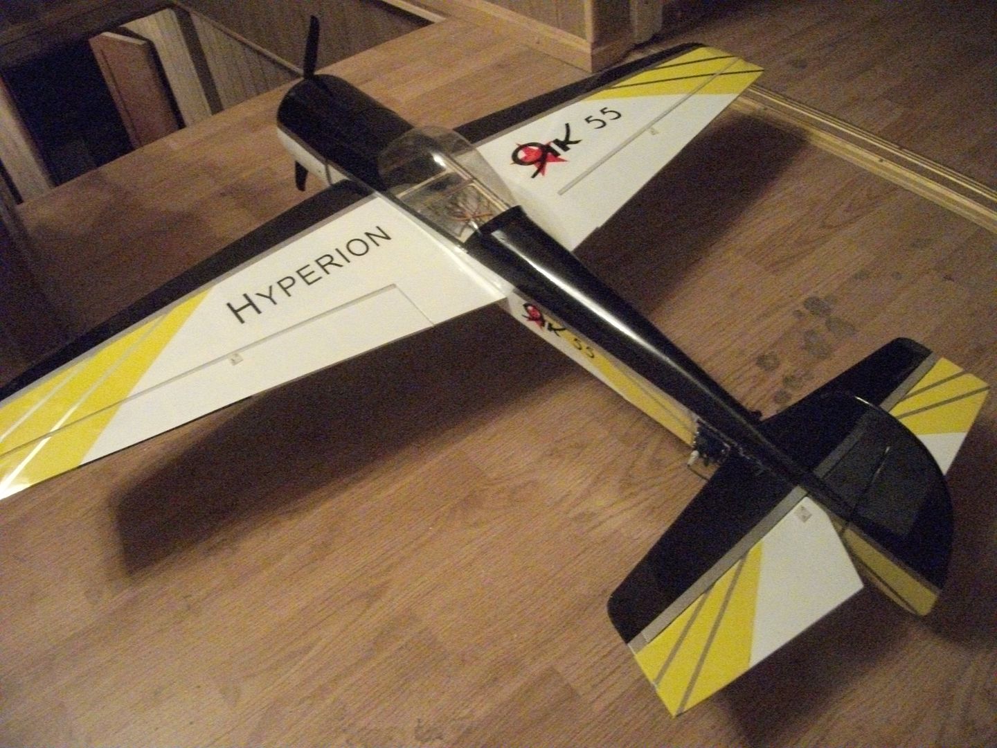

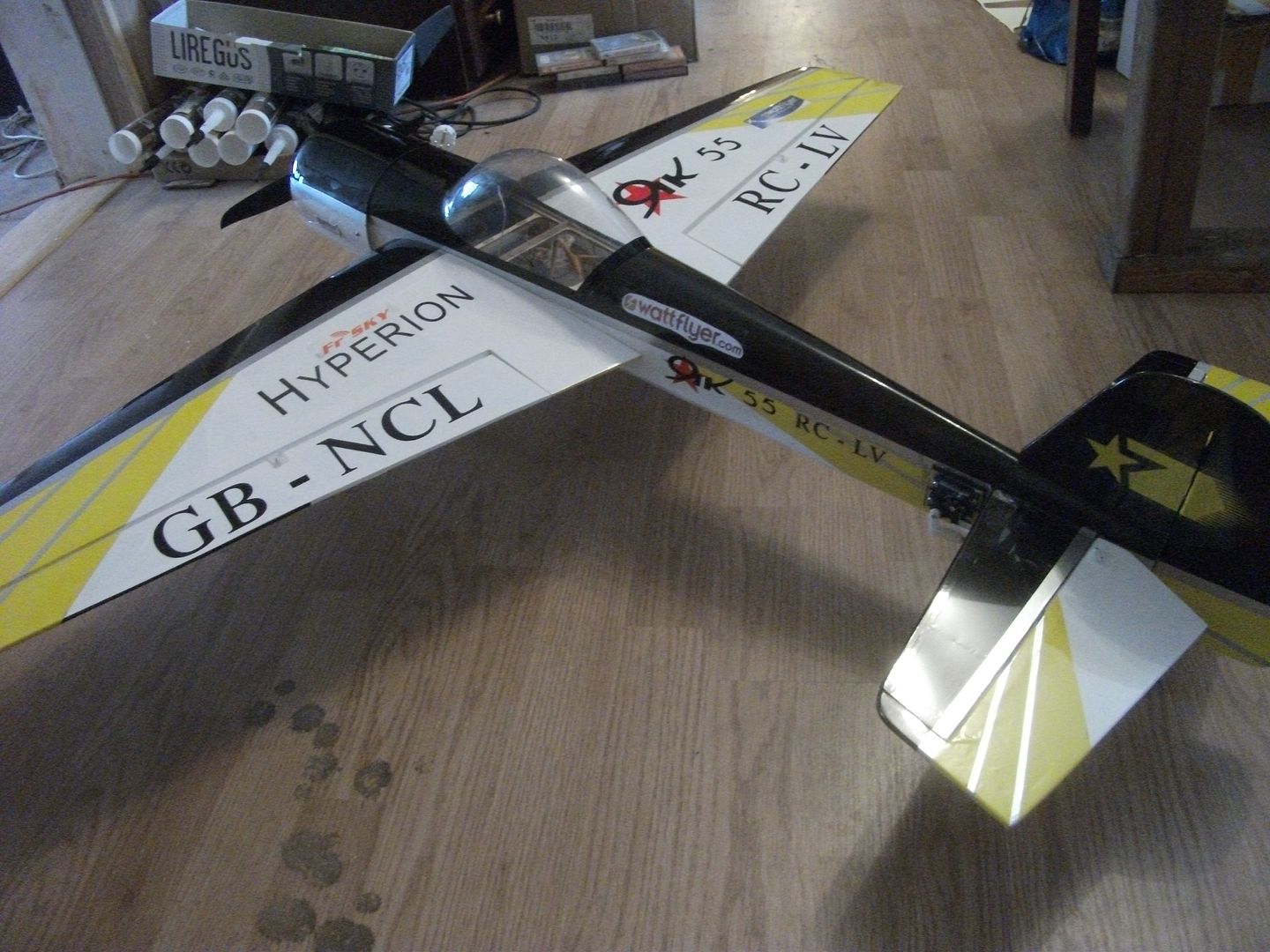

Well took her out today ......
Stuck a 3s 2200 in her .... opened throttle and she flew like a bird !
Balance was as rear as you'd go but made her really responsive. For a first flight I was careful just to see her fly.
Gave her a full throttle blast and canopy blew off ! Fell at my feet ! Landed put it back on ... took of again ....

The second flight - the engine mount pulled away .... even though I had run CA round it all. 5 min epoxy has sorted that better.
Very happy ! Motor on a 10*6 prop gives just over 1:1 .... so waiting for 11*7 to put on there .... I also have 11*5.5 's coming.

Well I knew I should not have flown her on a rough field ... plus my too hard a landing !!
But Epoxy at home and a supply of 2mm Lite-Ply saved her ... She's all back ready to go again.

Today - weather was real crap !! Snow then rain ...
So I sat there looking at the Yak .... and that out of alignment tail annoys me ...
Out with the Dremel ... select the engraving bit ..... I cut into the tail to fuselage joint both sides under and over the stabs ... Cut some thin card and inserted into the joint under one side to 'tip' the stabs level to match wing. Liberal dose of thin CA to fix it all again ... She now has a perfect aligned tail and you'd really have to look closely to see work had been done.
She's had an extra magnet fitted to hold the canopy ... sliver of card to level the stabs .... thin LitePly doubler to motor mount .... epoxy run round motor box and its mount ..... sheet depron shelf added behind wing spar tube to carry RX etc. : These are the only modifications apart from repairs.
