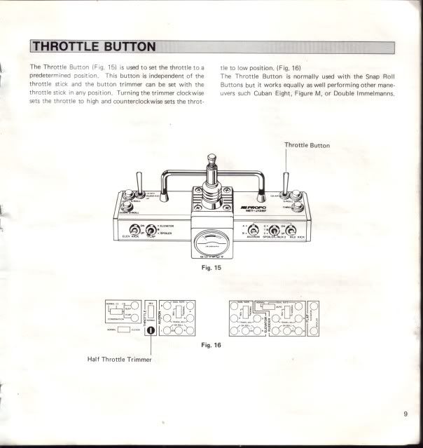

Sorry BD ... I'm losing the point of Idle Up in this discussion ..... Throttle Up I understand with Fixed Wing as I posted after yours ... but Idle Up means FULL throttle at Bottom stick as well as Top stick - with centre as minimum. Why would you apply a Helicopter Idle Up setting to a Fixed Wing ?
Throttle up where you flick a switch and it applies a minimum idle throttle - yes agreed ... and I agree a warning would be nice ... don't really like the thought of that meat cleaver churning away on the ground at closed throttle !!
My old JR Propo has a dedicated Throttle UP momentary switch ... designed to be pressed and held when needed ... as soon as you release - throttle goes back to normal ...
(mine had a couple extra switches added .... but that's another story).
And that was in the days before digital programmable .... but of course it cost an arm and a leg to buy !!
