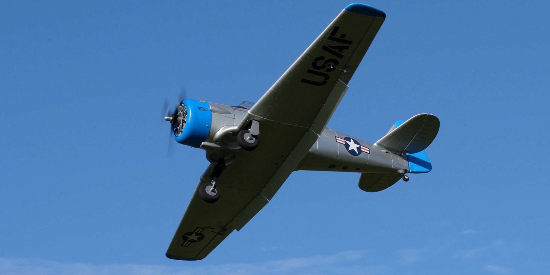

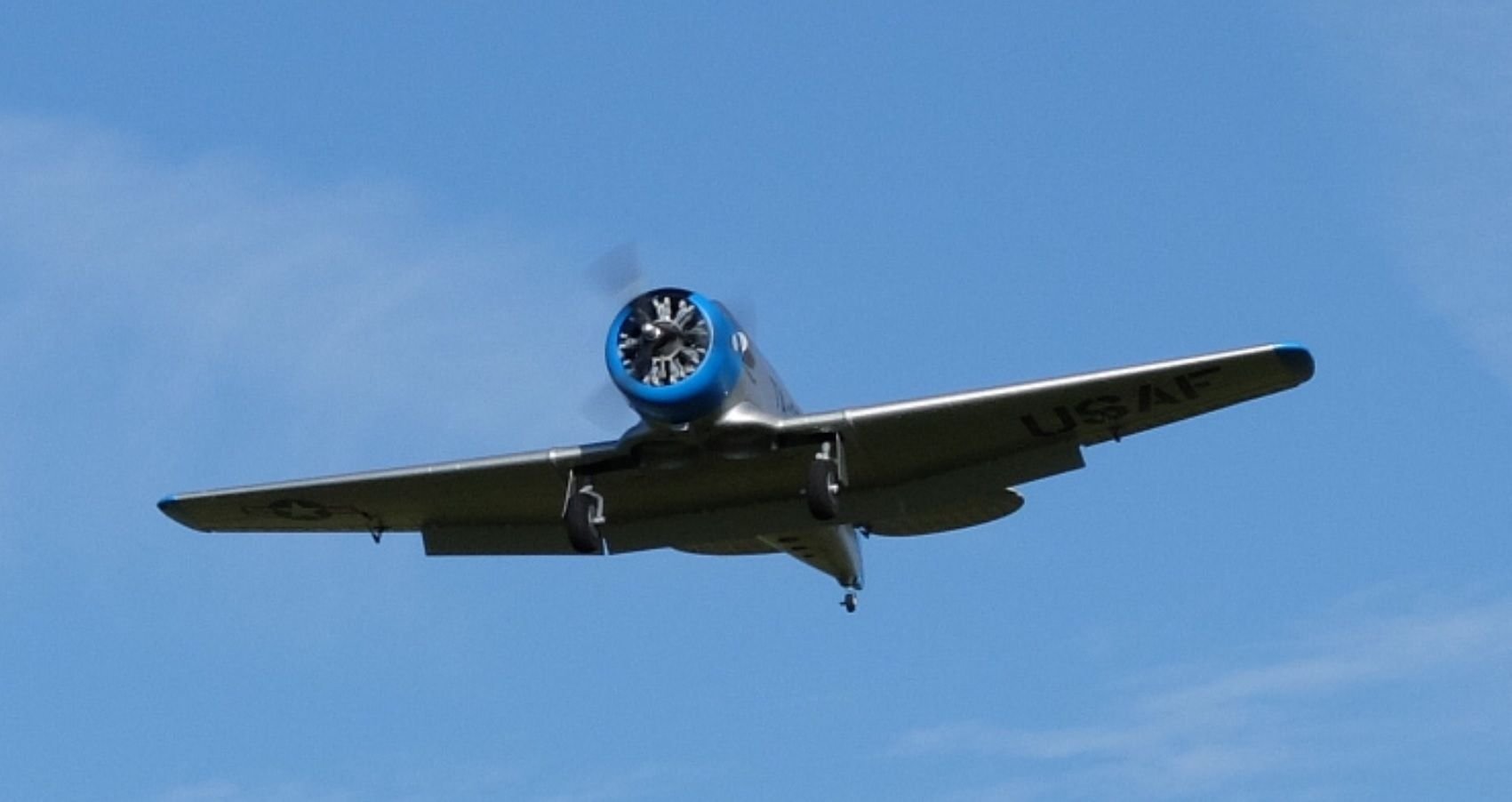

For about one solid week, I had to determine how to lighten UP the Frontal FUSE area (Business End) of the E-Fite AT-6 Texan 1.5m model because the fully assembled 3D Printed 9-Cylinder Radial Engine tips the digital scale at over 3+ ounces. Of course I had to eliminate the Model Motors AXI 2826-10 because just the motor weighed in at 7+ ounces and the STOCK ParkZone 15 was almost 6+ ounces so, I was at a dilemma of sorts. Also, the internal housing (main 3D Printed Radial) had limited space so, the selected motor had to be nothing over 30mm in diameter and length had to be nothing over 30mm.
I looked and looked and noticed that I had a few Park Zone 480 motors available and they have been very good in both my Park Zone T-28 Trojan (1.1meter version) and my Park Zone P-47 Snorting Bull (1.1meter version). I made some initial measurements and fit-checking and it seemed to fit the Bill for a possible solution so, I went for it. I had NO Issues and NO worries that this motor (Park Zone 480) with 30mm X 30mm was not up to the task of flying the larger and heavier E-Flite AT-6 Texan (1.5m). The big issue was Center-Of-Gravity issues and was able to absorb most of the worries by installing the Solid Muffler piece that came with the 3D Printed Radial Engine Kit which initially instructed me not to use it.
Assembly of the 3D Printed 9-Cylinder Radial Engine was almost like building a Plastic Static model but, with the difference of having the parts snap out of the honey-comb surrounding molds and carefully used a hook pick tool so as not to apply too much pressure while taking out and separating the very small parts. This same Hook Pick tool was used to clean OFF any excess material of the left over Honey-comb material and provide a good alternative from using drills and other power tools. Fit checking was super important in this Project (just like a normal Plastic Kit) such that before you use any glue you are certain that ALL parts of the Radial Engine kit was ready for permanent assembly using glue. The best glue that I decided "is" a relatively new product (at time of this write-up) was the GORILLA CLEAR GLUE and found it at the CRAFT Section at Wal-Mart. It was an incredible selection of glue as this GORILLA Clear did not leave any residue of any kind and allowing the parts to fully cure made a super strong bond, much better than plastic glue!
I found my long lost MOTOR-CALC sofware (version 8) and verified many of the Park Zone 480 Parameters based on the actual Static Testing and they all came super close and the Opinion was right-on the actual flight characteristic of the model when it finally flew. A few buddies help with the Still In-Flight Pictures and a Video of the Flight of the model. The first flight the model exhibited a slight Tail Heaviness and compensated with trim, however, the landing was full of bounce due to the condition. The 2nd Flight was performed by adjusting the Battery pack Forward and this improved greatly the Flight and most especially the landing of the model and trim was to the Elevator was no longer required.
I am going to spare you ALL with the Grossly Details of ALL I did and this post is meant to provide you with a briefing of sorts on the 3D Printed 9-Cylinder Radial Engine and what I did to compensate for weight savings to allow for additional weight distribution as a result of the 3D Printed Radial. It is my thoughts that someone could implement this 3D Printed Radial Kit using the STOCK Motor that comes with the E-Flite AT-6 Texan (1.5m) with adjustments of using stand-offs for the 3D Printed Engine Radial as it would need a little more shift Forward because the Park Zone 15 is longer than the Park Zone 480. Center-of-Gravity is attained by sliding the Battery Pack AFT and there should not be an issue because the Park Zone 15 has the same exact diameter as the 480.

I was so pleased with this Project using the E-Flite AT6 Texan with the 3D Printed Radial and using the Park Zone 480 motor that I went back to the RC Club early evening which is something that I normally don't do and only when I have a late appointment with a new RC Flyer who needs more additional flight instruction when NO ONE is AROUND!
As one of five (5) Instructors at my RC Club I usually notice when someone needs peace and quiet without distractions so, I usually set appointments during late afternoons -to- early evening and allow my student RC Flyer to concentrate during their flight instructions. However, when it's just myself this means I really enjoying myself with a certain RC airplane model is when I alone re-visit the RC Club.
The third (3rd) flight was just majestic and graceful and conditions were just a slight breeze coming from the North - North West and occasionally wind direction changed as some cloud cover was passing. Take-Offs using Flaps were once again used and the model just lifted off like the true scale model that it is. NO FLAPS were used during landings as I wanted smooth and uneventful landings with good airspeed and no bounce main gear touch-downs. The model didn't disappoint.
I am very pleased with the overall project of the 3D Printed 9-Cylinder Radial Engine Bust by Peter in GERMANY as it forced me to consider a lighter and shorter motor such as the Park Zone 480 and with terrific results for true scale -to- moderate acrobatics.
Hope this has helps others who would consider any 3D Printed Projects to give your models a nice touch of scale at the Business End.
