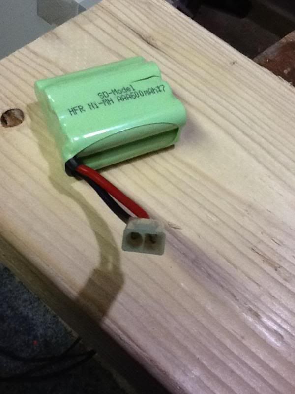

I'm trying to get back into the hobby, and all of my batteries are too weak, so I need to buy some new ones. I was a newbie years ago when I started, therefore I am still a newbie, so my terminology is a little elementary. I was hoping you guys could fill me in on what kind of battery connector this is so that I know what kind of battery to get. I know that it is a 7 cell nicad battery, but that is about all that i know. Thanks in advance!

To answer the original question, that is a Mini Tamiya connector

Connectors are the old standard TAMIYA plug used on cars / brushed motor planes for years ... but so temperamental ... they have been replaced in general use by Deans, XT60's etc.

Hi, Thats not a Nicad battery but a NiMH , 7 Cell @ 8.4 Volts
