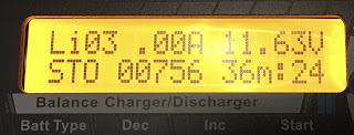

33 minutes later a set of continues beeps announced that the battery was charged.
After the charge is complete we can check the voltages by putting the charger in "Present Testing" mode. During the charge is possible to switch between status and cell the voltages by pressing the [Dec] and [Inc] buttons.

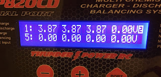

I proceeded to verify the reported voltages on my ThunderPower charger:
