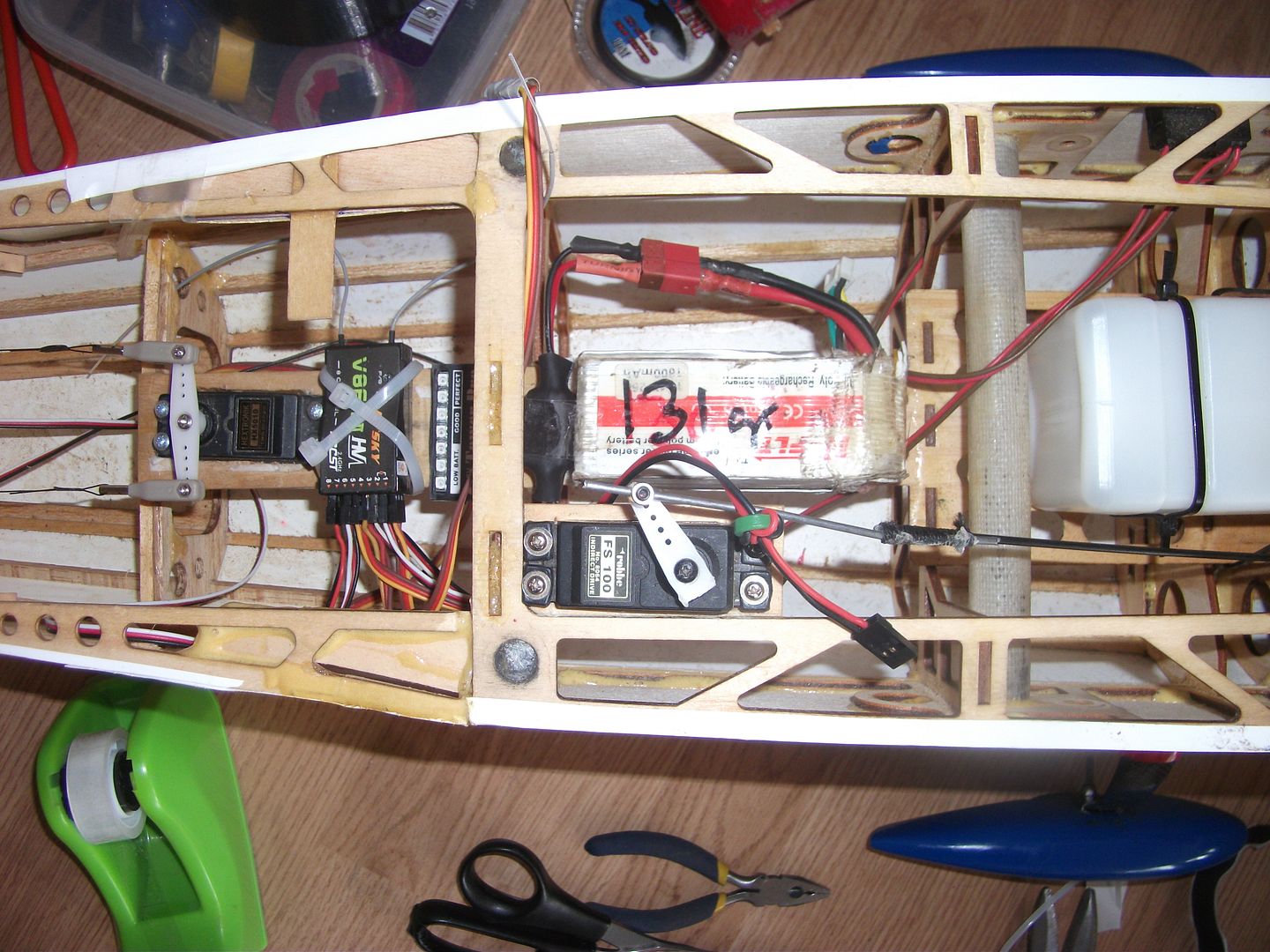

Here's my 58" Extra with Pull Pull .... look to left of photo and you see the rudder servo and connections ...

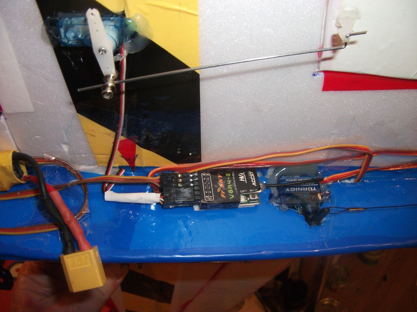

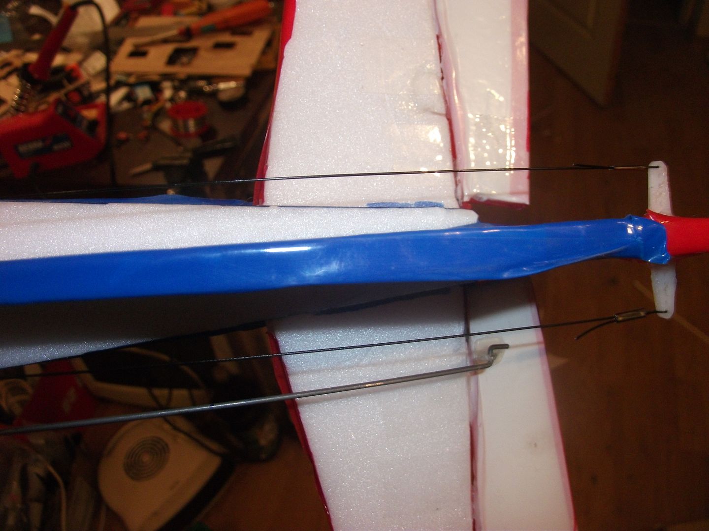

Here's using servo dual arm through a rudder to give horn either side .. with cable crimped :
Here you see other end .. similar ... its a small 30" model lightweight so no big deal to just use Tx trim to adjust.
Yes with this I get slight slack of cable when deflected BUT flight performance is not affected. You also see the screw connectors set so I can adjust while still fitted to servo .. here on aileron.

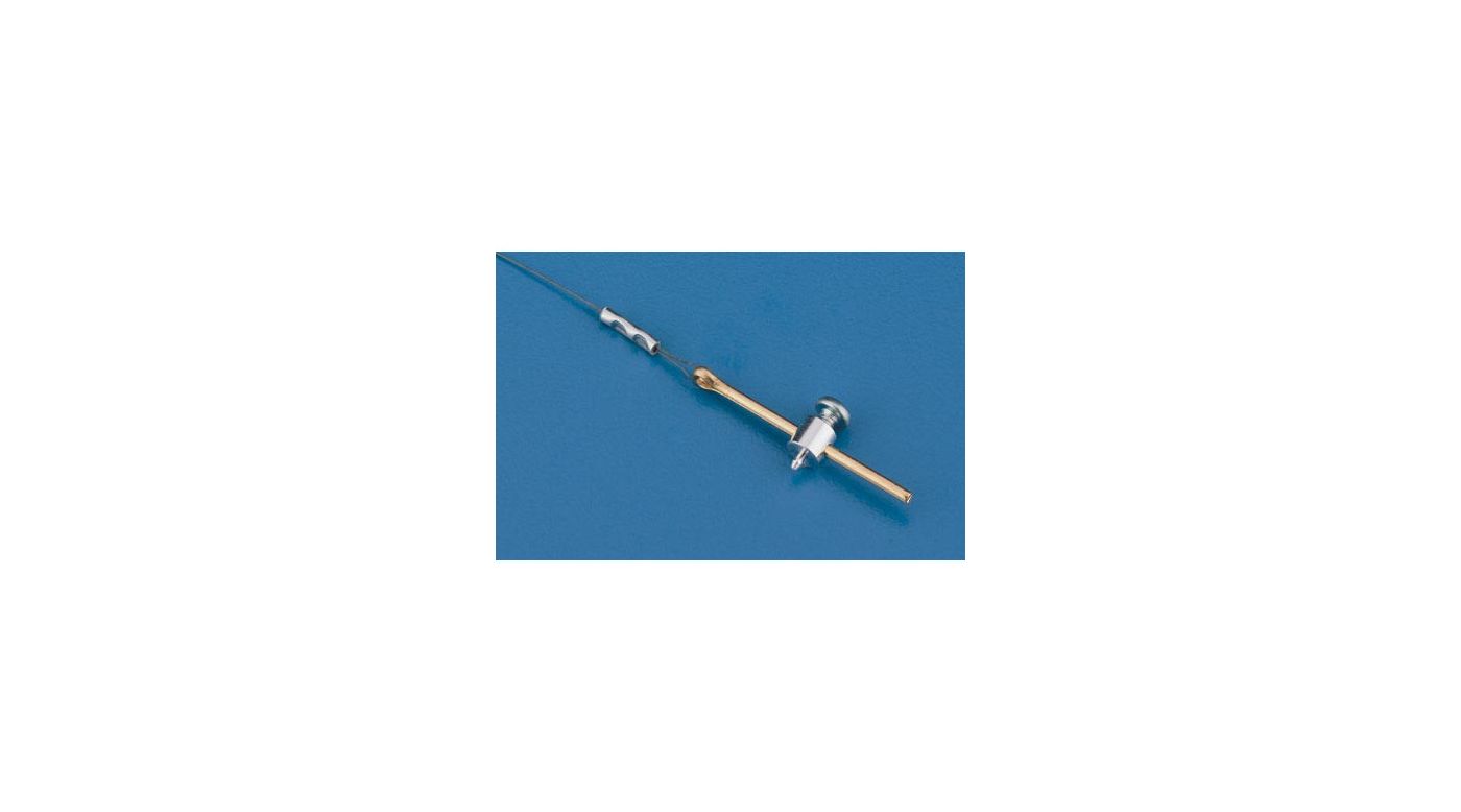

You can use these :
http://www.hobbyking.com/hobbyking/s...mm_Length.html
or lighter and better in my mind :
http://www.ebay.co.uk/itm/2MM-SOLDER...cAAOSwqu9VT4qg
