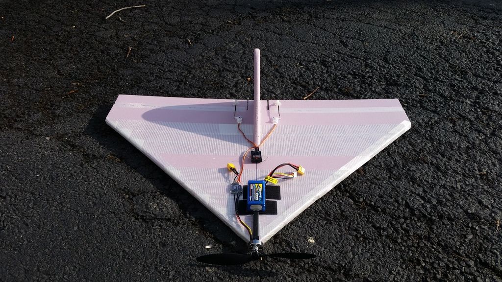

Hey everyone, I'm new to flying and of course new to building foam board planes. I've built a few that fly great and a few that didn't.
What I'm looking for is pics and ideas on some of your best flying foam board planes. Specs or a link to a built thread would be great. I prefer simple designs that can be built in an afternoon, but feel free to post anything you want.
Here is the latest one I've built that flies great! I'm not sure if it helps or not, but when taping this foam I kept it bent slightly to create a bit of dihedral. It sure seemed to fly smooth and stable. The tape made it very strong and rigid.
1/2" pink foam, 1300KV 24 gram motor, 8x3.8 slofly prop. AUW is 12.5 oz with a 1300mah 3s. Wingspan 30".
Here is the maiden, all was going great until the motor fell off. I've since repaired the mount and it flies awesome now.
