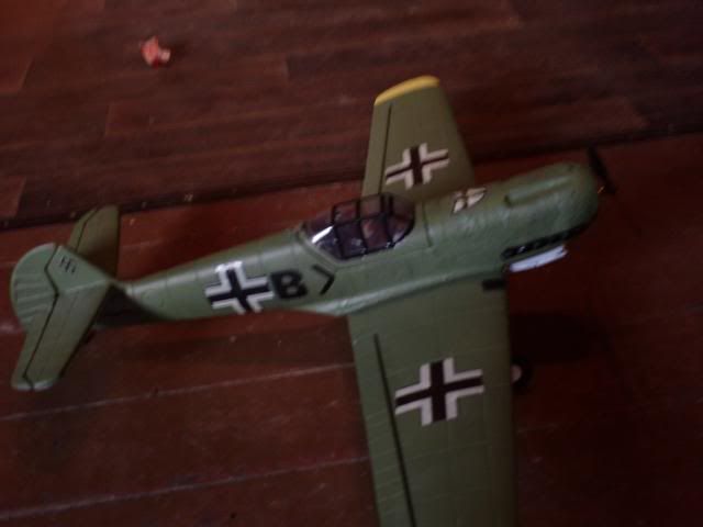

Ok ... reference my OP .... here are a few photos to show the mods ....

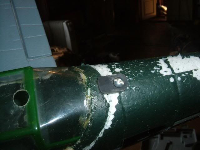

Canopy catch - piece of plastic with simple screw glued into the foam - no need for fancy thread etc.
(Note this is before I repainted model ....)

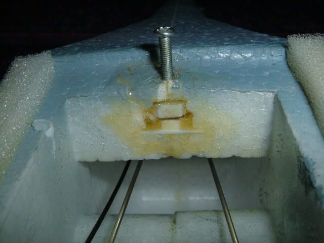

Here is the wing holding nut inside fuselage that you can see has already had to be repaired .... I use epoxy for stressed areas for it's strength .... the nut holder is simply held in the foam ! ...
I replaced with the prop hub and plastic plate ...

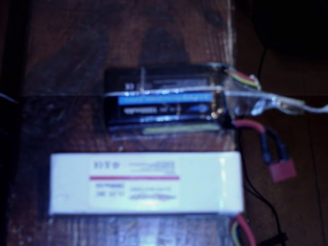

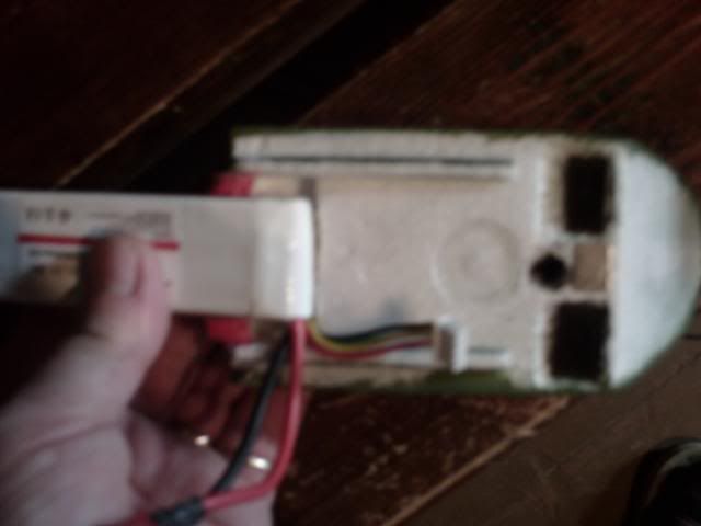

Ok onto battery pack - original model had slot designed for a 9.6v NiMh 650mAh pack of 2 rows of 4 cells ... I upgraded to a 3S 1000mAh LiPo and Brushless which battery pack fitted the slot OK. I had measured max dimensions and was acreful to buy only that which fitted.
The black pack is the 1000mAh and white the larger 2800mAh ... (note the clear-tape and thread 'pull tie' I have so I can pull it out of battery slot without using leads !
Pack doesn't fit !

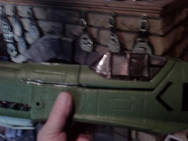

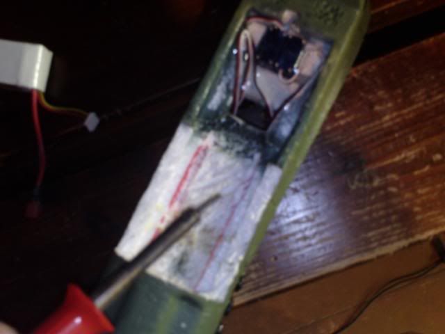

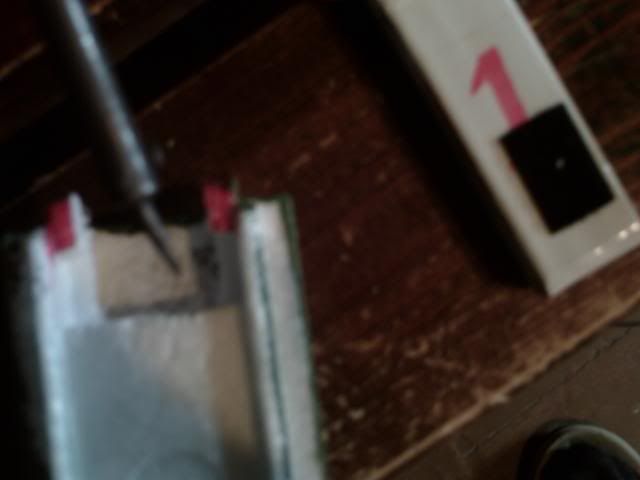

Cut away fuselage top ...
mark and melt away excess to fit pack ...
including canopy ..

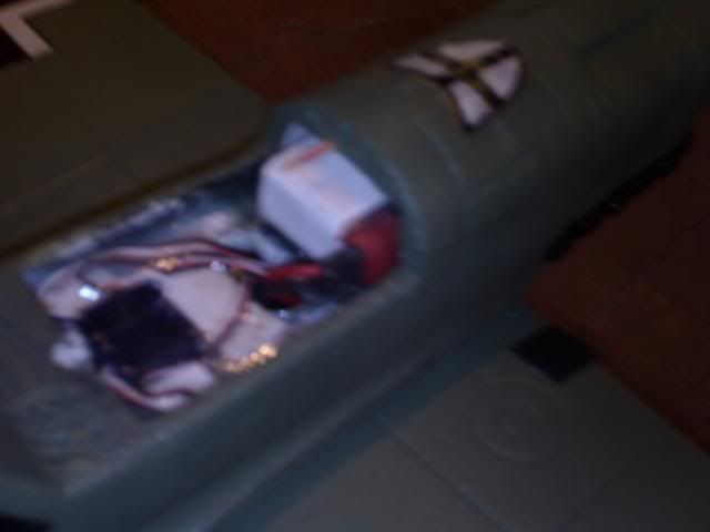

This is better ... now it fits ..
Ready to do battle again (note I'm also part way through new paint scheme ...)
I know I could have done a better job of it - but the model has a lot of battle scars and hangar rash - and is my knock-about return to RC flying hack .... so looks are not so important for me - the flight is !!

lots of rehashing looks very authentic lol nice brasses on the fireplace as well.

I wanted to do a bit more like real WW2 version than the out of box toy-like look. In the end I stayed of complete scale authentic as the decals are self-adhesive and I have no access locally to replacements. I thought about painting them ..... but then thought well - as long as it looks near enough, it will be ok. I'm reasonably pleased with it. It certainly looks the part in the air.
The Brasses ..... as a Brit - I have tried to have my little bit of UK at my home .... the Brasses are part of that. A number of them are actually presentation for my services at Catherington Shows over years ... my Ex UK Wife and I ran various Scout things at the shows ... my expertise was putting up and maintaining the aerial ropeway .....
Anyway - back to the ME109 .... yes - quite pleased with it. But lets be honest with Foam - it's so much easier to revamp etc.
