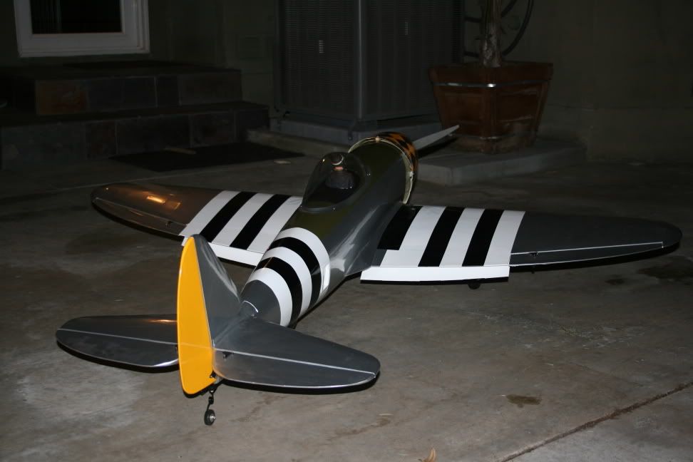

World Models P47 Thunder Bolt
Wing Span : 70 in / 1780 mm
Wing Area : 893 sq in / 57.6 sq dm
Flying Weight : 10.7 lbs / 4850 g
Fuselage Length : 62 in / 1580 mm
Engine Required : 4-stroke 1.20 engine(AXI)
Radio Required : 6-channel radio w/ 7 standard servos and 2 low profile retract servos
Key Features
The World's 1/7 scale warbirds collection
Functional Flaps for smooth landing
Pre-installed retracts
Pre-painted fiberglass cowling with 3D template
is now ready to go
running on
AXI 5320/28 18x10 prop
8 x 3700mah rhino's
around 1KW
should give around 10 - 12 mins flight

Be curious to see how you like it - I maidened mine (26cc gas) yesterday. Unless you've beefed up the wheel strut covers, they'll flutter like hell. Also - check the black stripes on the top of the wing with a moniokote iron - I had one come about half off.
I'll be curious to hear what your AUW is once the batteries are in.

Landed fine, was at full flaps into maybe a 10 mph head/crosswind. Flap travel can be seen here.
No indications of nose over. Also - check where the wheels (replaced the foam crap on mine with Du-Bro) come up against the landing gear strut - I had to add a spacer to keep the tire from "grabbing" the strut.
Mine came in at 13.2 lbs w/o fuel

Could have landed without flaps - the runway at the field is pretty long - but I like flaps for the heavier planes. I used the supplied "monocote" to cover the retract hatches.
Thanks - I was pretty happy the way it came out. More pics are here (a few F6F pictures accidentally wound up in that folder too)
