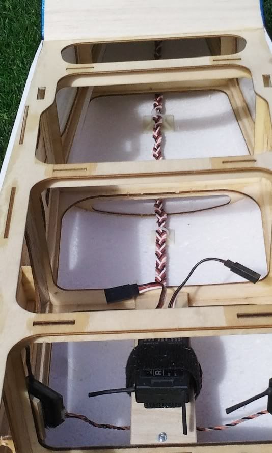

Well after a maiden flight on a 21 x 10 prop at about 3700 watts, the plane flew well with good power but was very nose heavy.
After adjusting the weight in the plane and propping up to a 22 x 10 carbon electric prop I have got the weight down to 16.50 lbs. Which I think is a very respectable weight for a plane on 12s 5000 packs. Hoping to get a few extra watts from the bigger prop too.........over 4Kw would be nice.
Have not flown it yet with the weight savings but can only expect good things to come from it !!

Congrats!
Very neat install. I like the braided rudder/elevator leads
