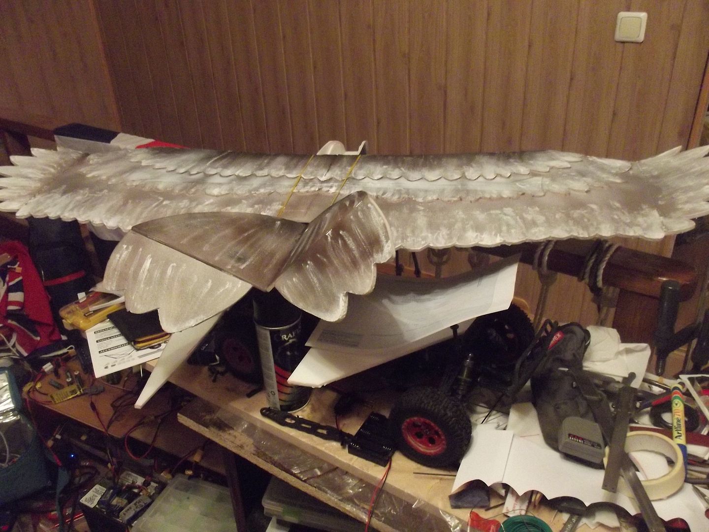

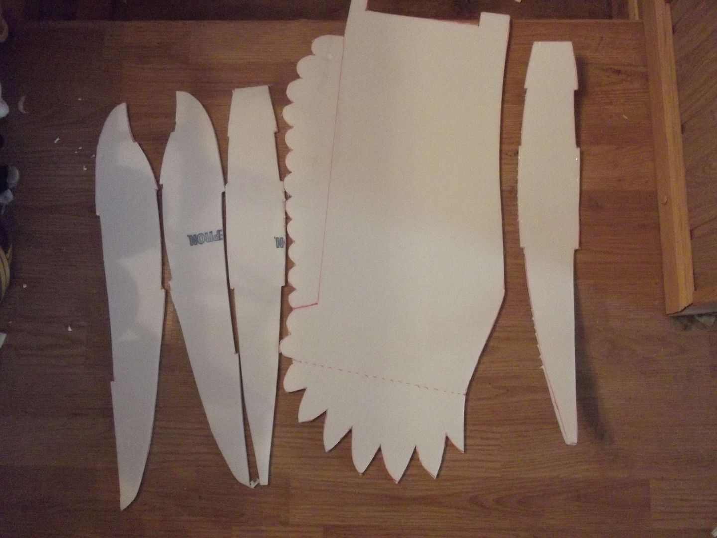

I saw one online and I just thought ... winter days ... box of Depron ....
Just need to mount and glue tail feathers ... add motor mount and RC gear ...
Its 56" span ... supposed to float around on a 3S small battery and small motor ...
So I have a Donkey 2204 .. 3S ... 8" prop ...
To be cont'd ...

Bit sparse on how to put tail feathers on ... has tail piece as well - doesn't seem to fit ...
I didn't like idea to have 3 layers of 6mm for the wing - so main is 6mm, then the two KF sections are 3mm ...
My spar is 9 x 9mm pine cut on my bench so I have uniform knots or faults.

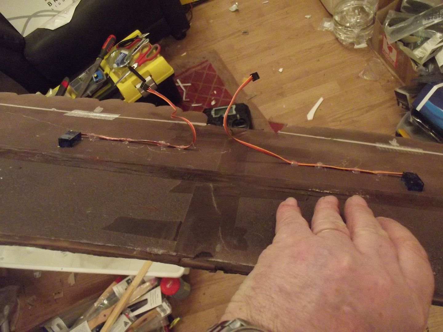

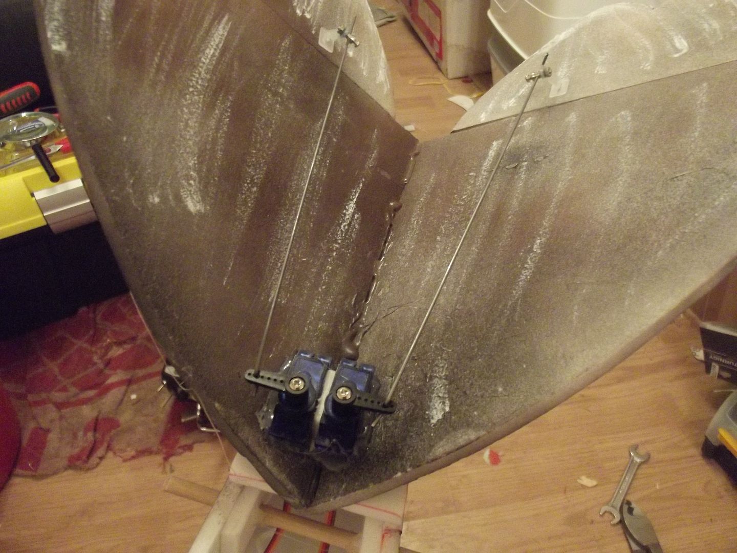

Servo set-up ....
The plan shows it as basically elevator / aileron .... but I thought I would use some old glider experience and add in V tail mixing.
So here are two servos for Elevator / Rudder via VTail :
And the two aileron servos mounted to top of wing to avoid damage on ground ..
and the leads under 'hot glue' tacked into place.
Simple 4ch only ... I did think to add spoilers but that would mean using more chs and the spare Rx I have is the 4ch ...
I think she'll be fine.
2204 1440 kv withy 8x4 flexi prop ... 3S 1750 ..... should see her away once I put all in and box her up - fueslage is still without top and motor ...

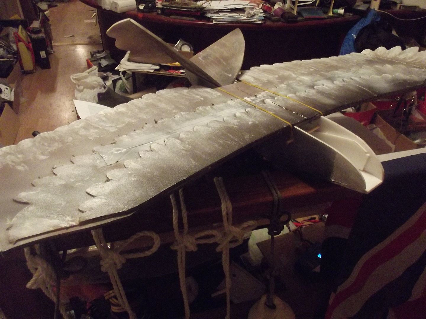

I've been away from home ... but now back ...
I've set Rx / Battery / ESC and she balances spot on the recc'd point.
Just finishing the cosmetics ....
I'm undecided what to do with the wing - its big and very wide. To rubber band it needs really long bands ...
