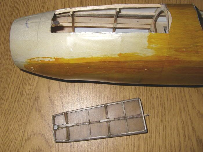

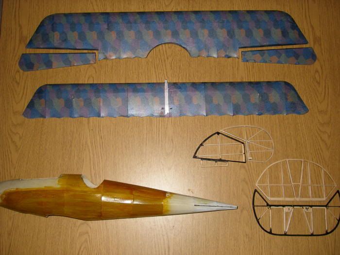

First I should mention, I've wanted an Albatros long before I even knew what one was called, so I was pretty excited to find this one.
This is from Cedar Hobbies, and I bought mine from ebay. The difference with the ebay ones is some don't have landing gear for some reason, but they do have wheels.
They call it an ARF, but it's much more of a kit than that. But to be fair, I've modified it a lot, and I'm sure some could just throw the gear in and be happy. I did not like the way the prop shaft just goes through the spinner, just not right. I also didn't like the shape of the nose. The fuse has a nice bullet shape taper, then all of a sudden, in the forward 2 inches, it sort of straightens out. I reduced the diameter of the nose, to make the shape more like the real one. I also painted the fuse to look like wood. I'm picky, and I am still fooled by it when I glance at it. Love that wood look. I also made a really nice functional (pivoting) tail skid. The fuse used to weigh 3.1 oz, now with tail skid is 3.2 oz. Totally worth it.
The plane is of OK quality, but it's not great. I've done a lot cosmetically. Hope it's not lipstick on a pig. It is not going to be super light by anymeans. Everything you get in the kit wieghs about 10oz. That's with no radio, electronics, battery, motor of course.

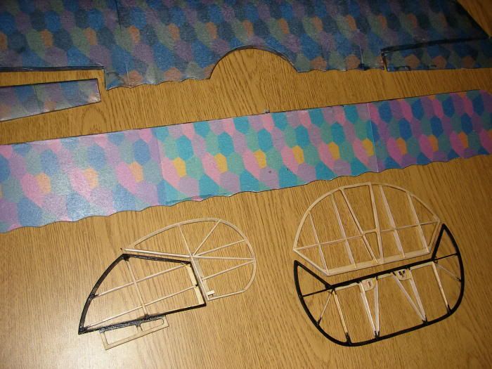

I've applied Lozenge "fabric" to the wings, both top and bottom. I printed on tissue paper, and then applied that to the wings with WBPU. The tail feathers were terribly warped, so I cut the guts out of them, and installed an ever-so-slight airfoil with balsa to them. Then I covered with Silkspan. The original tail group was 21 grams, now they are 25 grams. So, yes, this plane is adding up. I'm trying very hard to keep it around 15-16 oz when done, but it's a challenge.

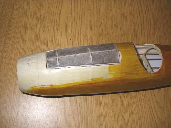

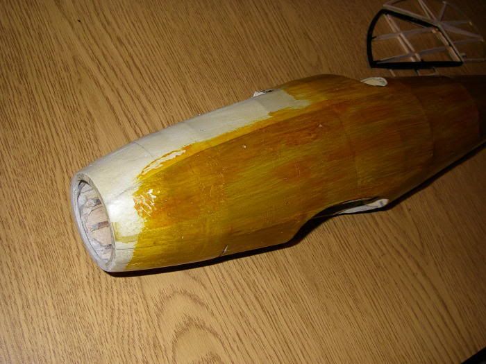

Right now, I'm finishing up a hatch for interior/battery access. There was no way of getting inside this thing as designed. This hatch is where the real planes engine would go. I'll be making a foam or balsa engine to stick to this hatch.

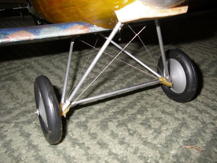

Next up is the internals, I'm going to use a pull-pull method. Soon I'll be making the landing gear from carbon fiber tube, and it will be sprung like the original.
What I'm NOT happy with is the fact that the lower wing had a warp in the left outer end, the leading edge was twisted down. Probably almost 1/4 inch. And both wings have (forgive me if this is the wrong word) REVERSE Dihedral, as in, they both droop down, ever so slight. I'm not by any means an expert, but I think the Albatros has slight normal dihedral on the lower wing, and the upper is flat? I did manage to fix the lower wing, with a heat gun and some blocks under the tips.

Ok, here's the current pictures...

Printing on tissue was a pain - At first. I first tried to tape down the tissue to printer paper with scotch tape. The printer didn't like that. Tended to jam up. Also, I realized that the tissue needs to be secured on all 4 sides.
I ended up using a glue stick on the perimeter of the printer paper, then laying that down on to the tissue. The tissue I used was just regular wrapping paper type tissue. It is very thin. I found that it didn't really matter what setting I used on the printer, the fast draft setting seemed just as good as a higher setting.
The hardest part, (other than not using tape) was just getting the size of the lozenge art file correct. Basically you'll go thru a lot of ink on normal paper until you get it right. I did mine on 8.5x14 paper.
Applying it to the wings was pretty tricky too. I lightly sprayed down the wing, and the back side of the paper, then layed it down carefully. I honestly don't know how else to explain that part. It was hard to get it right. You pretty much only have 1 chance. It will slide around slightly, but not much.
I REALLY wish I'd done this printing on SILKSPAN, and just started from scratch, instead of puting it over Monokote. Would have been WAY easier.

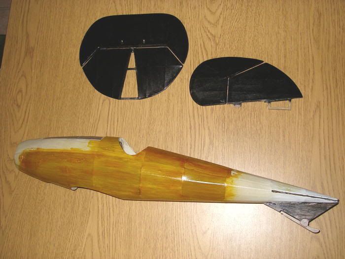

One thing I forgot to mention - the way this plane comes, the tail group is VERY unscale. It just occured to me a few days ago, can't believe I didn't notice it long ago, with as many Albatros pics I've been looking at. The verticle is too far forward, and the horizontal is not "LONG" enough. The front edge of each should be the same point fore and aft. I did move the verticle back as far as I could and still get elevator movement, but it's certainly not scale. That's OK with me, I'm not quite THAT picky. Still looks like an Albi!

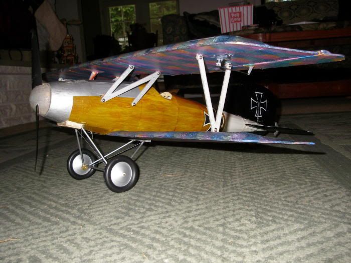

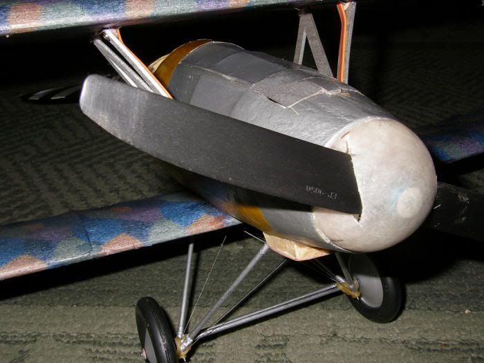

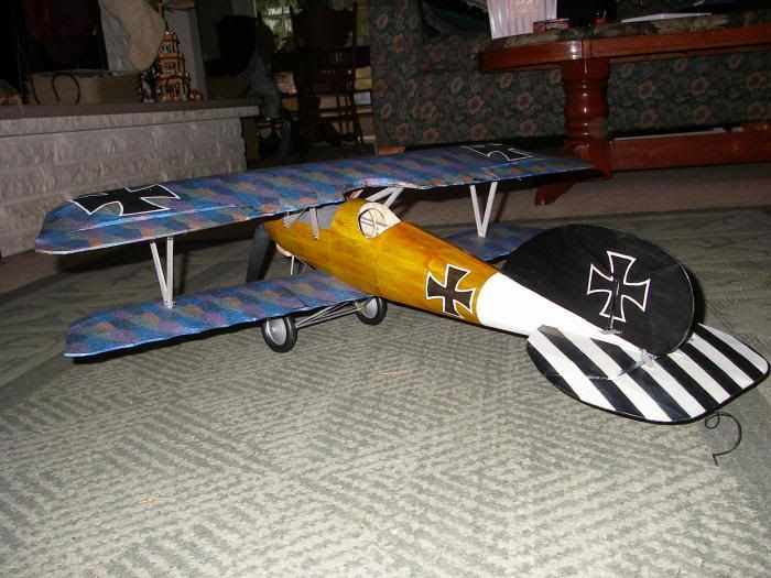

Here's the semi finished pics. I ended up doing a black and white stripe around the nose, just aft of the cone. And I painted the cone in a black and white patern, to keep with the theme.
I'm just glad I left the cone at home for the maiden! (oh, the cone is about 5 layers of .5 oz fiberglass formed over a mold I made.)
Now I just gotta get fixin'. Damage isn't really too bad, mainly where the lower wing joins the fuse, and little tabs inside the wings for the struts are broken off.
