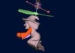

We sent the model to a laser machine that can create a computer image of the model.
You can see how it looks in the attached images:
When satisfying with the results, we created rough sample made of Styrofoam in order to determine the correct position for the shafts, blades, motors, battery, receiver/controller, etc.
After getting the correct position we sent the sample to create another computer image:
