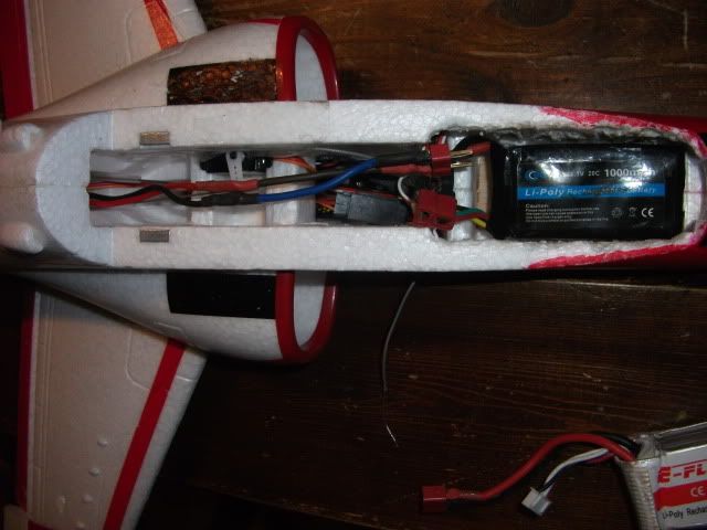

Sorry, I can't help you with the T-45, but I have flown the F-18 and the Mig-15 (my new plane). The F-18 flies great with no cg issues.
I flew the Mig for the first time today in 15-25 mph winds. The plane seemed a bit tail heavy to me, but its hard to really tell flying a new plane in those winds. I was chasing it all over the place, but was able to maintain enough control to land it safely.
The battery compartment is REALLY tight! The Lipo is up front and the elev servo and receiver are side-by-side (see photo). She has plenty of power, but I need a calm day to figure out exactly how she needs to be tweaked.

I'm just surprised that the LiPo is so far fwd on the T-45 ... with servo tucked back at rear of slot.
I can slide my RX under the servo so that helps ... but still leaves LiPo right up in nose.
What I'd like to see is a photo of another T-45 set-up to compare ...

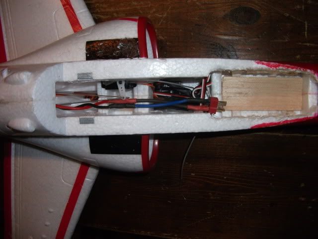

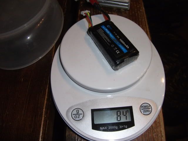

I enlarged the battery area and then fitted a 1/16th light balsa plate in to give back strength ...

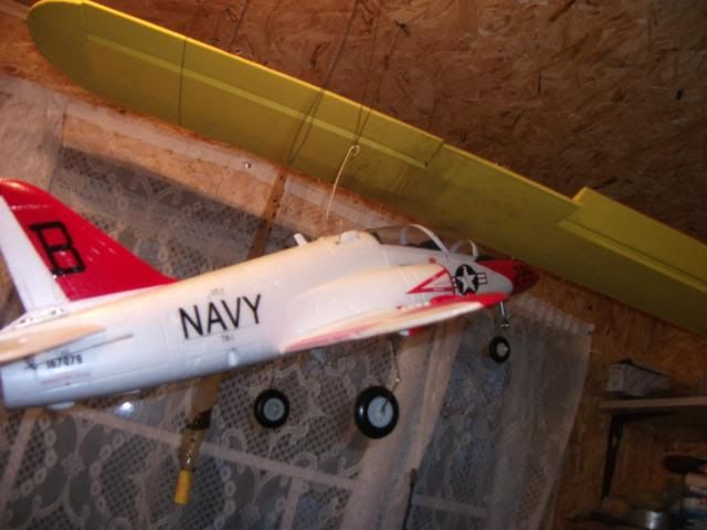

Here with 1000mAh 3S 20C at 84gr ....

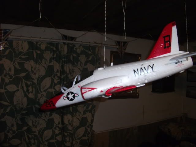

In model ...
Hung at CoG point via my "skyhook system" ... (old flybar from my heli bent and hooked to string from ceiling ... hole is made through fuselage and a plastic tube inserted through for wire to feed through .... )

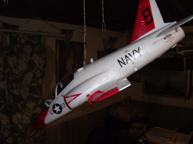

Here with 1800mAh 3S 25C at 128gr ...
In Model ...
Hung at CoG point ...
The 1000mAh is only about 10gr's heavier than the spec'd 850mAh 3S ... so I'm surprised at the nose heaviness ....
To get to a slight nose heavy setting - needs 60gr at tail end with the 1800 LiPo ....
I've checked all weights and there is no way that the model can ever meet the stated weight in the advertisement of total Flying weight 330gr. Lowest I can get it to is 385gr. with advertised 800mAh LiPo weight allowed for.

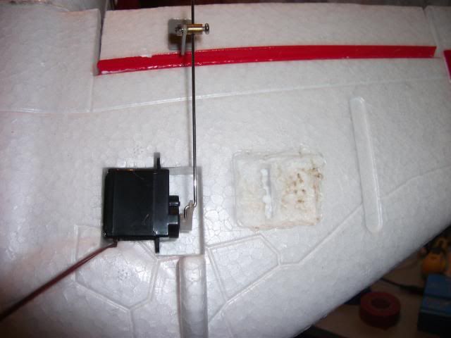

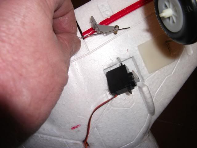

Only downer was that the aileron rods being under wing - I stripped one servos plastic gears in landing second time.
This is not a simple matter to sort - as the wing is glued in place with servo lead going up into fuselage ... luckily the servos are exact same as the Skyartec Cessna's that I have just modified to separate aileron servos. That meant I have a fully working Skyartec servo in hand. I took the gears out of that ... fitted to T-45's servo and she's all fine again.
When I run out of gears - I shall replace with metal geared servos and that should sort that.

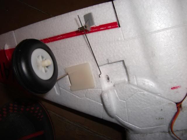

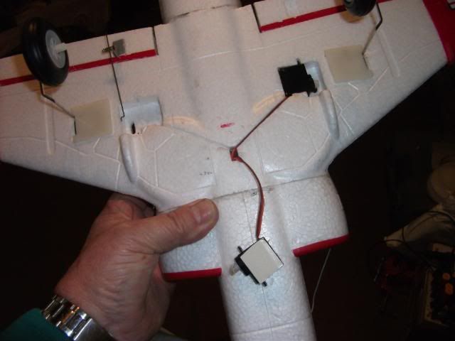

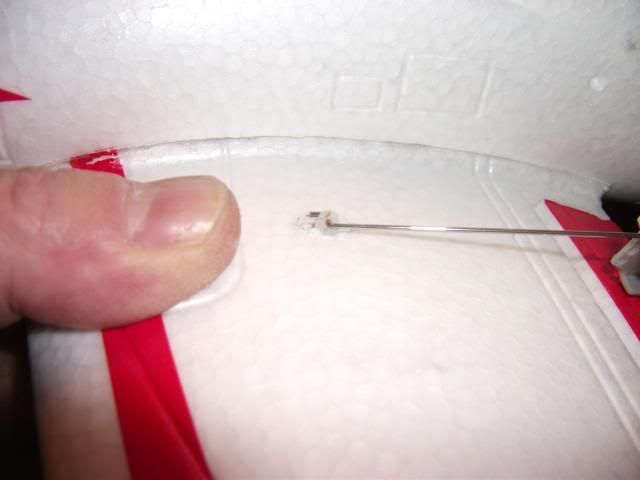

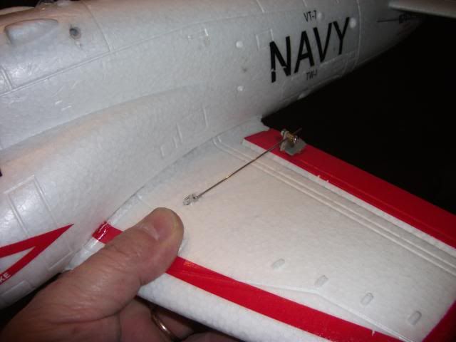

Today made next modification to her (not for speed - this is just for my convenience to save hand-launching when on my own ... )
The EDF mini jet as supplied by Hobbyking is without the wheels that Skyangel supply ... yes it is better without and looks nice "wheels-up" in the air.

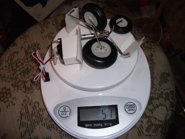

But I like ROG and wanted wheels option. So wanted lightweight wheels but with reasonable legs.
The Stinger 64mm EDF of Hobbyking has fixed wheels option that can be bought separate, about $6 which also includes a 9gr nosewheel servo ! Paypal made and they arrived today.
Main wheels are a touch large - but they can soon be changed down in size ... legs are good, mounts are such that legs can be removed easily for hand-launch "wheels-up"..... leaving just the nose pin and flat mounts in wing.
Here's whole lot on scales ... not too bad considering servo included as well ...

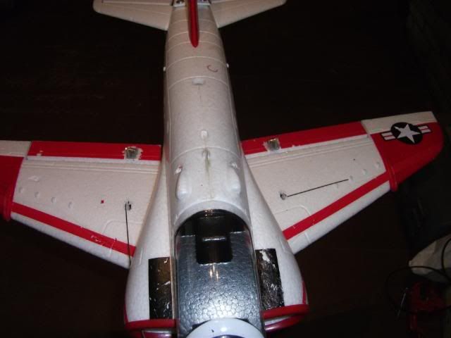

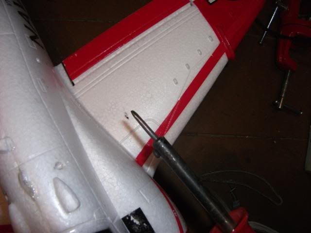

First main wing ... which has Skyangels slots already moulded in. These have to be enlarged a touch by use of soldering iron ...
Flat plate mounts epoxied into place ..
Front mount being offered up ...
Soldering iron needed to enlarge nose aperture ... but luckily the nose has a hollow inside that just allows the servo and box in. The battery is against a bulkhead that sits at back of nosewheel box - so that's clear OK. The servo lead is long enough to skirt battery and reach RX.

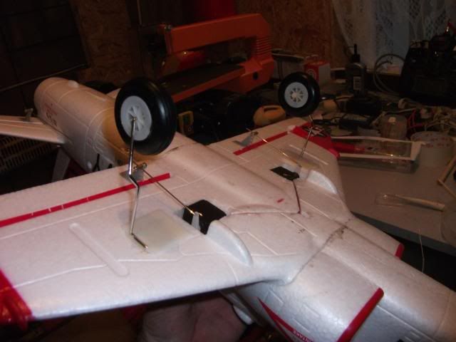

Main gear slotted into mounts ..

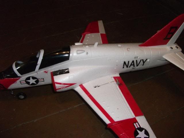

Fitted :
AUW without battery is 375gr ...
With 1800mAh 3S 25C = 504gr.

I've now fitted HK's Stinger landing gear which is removeable for hand launches and best flight set-up. All up ready to fly is now 504grams with gear fitted .... (total gear weight including nosewheel servo is 57grams).

First mod I've done is to fit Hobbykings Stinger wheel set ....
There is one area of concern - the nose wheel is heavier than anticipated with the servo installed in the mount.
AUW of the model is now touching over 500gr ... so EDF power is going to be a major consideration next.

Just checked back in on your thread. The landing gear mod you made is very nice! $6 for the set with a steerable nose wheel is a great price.

Right back to the nitty-gritty ..... have done some tests now that I'm back from I*** desert and home ...
Wattmeter comparison figures at WOT ....
1800mAh 25C 3S E-Fly pack I used in the video .... gave 210W with 18A
so I tried a recc'd 800mAh 20C 3S pack as you have in your Mig ? Its a Turnigy new pack as well ..... gave 170W with 16A ....
then I tried the pack I intend vto be my 3S usual pack to offset wheels weight - 1300mAh 3S 25C - this gave also 170W at 16A ... cycled it on the charger and FRESH of charger got 18A and 220W ... but thats with the pack straight from charger to model.
As an experimenmt and to prove apoint - I plugged in one of my Trex 450 heli packs ... 2100mAh 3S 35C and it near ripped the DF unit out !! at 240W and 21A
I tried various packs I have ... some old and some rarely used. It seems the average is 170 - 180W and ~16A ..... which as you see from above is significantly less than my E-Fly 25C packs I used in it previously.
That is why my video shows such good speed / performance I reckon. You cut back W from 210 to 170 ... that's a 40W drop ... just under 20% less power.
I'm now concerned that the 1300mAh packs I have invested in may not be man enough to fly with the wheels at speed. It may wallow a bit.
But the good news is ... with 800mAh Turnigy pack - it balances dead straight with 32gr at back end and wheels fitted.... 440gr AUW
With the 1300mAh pack - it balances with wheels same as the 1800mAh pack without wheels as first flown...... 490gr AUW.
I am hoping that I can play around without wheels etc. and weight at tail end to try and regain some GO !
So it will be trial as soon as the snow and wind stops ......... its -2C out there at moment.

I don't even have to fly the machine - I can HEAR the difference in motor scream between the packs. The 800 is significantly less scream than the 1800 ...
Heres' some other info :
My AUW without LiPo but with wheels = 375 grams
Remove wheels leaving nose servo and mounts = 342 grams
E-Fly 1800mah 3S 25C = 134 grams ... (lightest / smallest 1800 I could find .... )
Turnigy 1300mah 3S 25C = 112 grams
Turnigy 800mah 3S 20C = 67 grams
I know you can add the numbers but I even weighed in flight ready to go form ...
Total 1800mah 3S 25C and wheels fitted = 509 grams
Without wheels = 476 grams
Total 1300mah 3S 25C and wheels fitted = 487 grams
Without wheels = 456 grams
Total 800mah 3S 20C and wheels fitted = 442 grams
Without wheels = 409 grams
So it looks like I will be using 1300 - 1800 WITH wheels and the 800's for no wheels hand launch days. Its the C rating that will decide ........ not the mah ...
Roll on 4S !!

A little mod that has been niggling away at me to do ... but I keep putting off .... 180 the servos - so arms exit top of wing. That way belly landings don't have the aileron rods / horns etc. caught in the grass.
I'd read that another guy had just 180'd the servos as is and the arms were fine.
Today I did it and he's right ... in fact the servo arms are nice and low and exit enough to attach the z link. The only down-side are the control surface horns are bit ugly. Plus the lacquer paint they use to decorate the model is poor.
Disconnecting and you can see the prominence of the horn etc that without wheels is lowest point of model ! ..
Making servo slot in wing with soldering iron ..
Lining up servo arm / horn ... here you start to see arm is only just proud of wing top ..
Servos double sided taped back into their slots ... horns epoxied to aileron top surface ... rods connected ...
and marker pen to touch up the red ..
I have to admit I made one error ... I placed the horns so that the screw adjuster is on the inside making it difficult to adjust. I should have mounted the horns to have outside ...
Later I may replace rods and connectors with clevis and threaded rod to reduce hardware visible.
At least now I can stay with plastic geared servos and not worry about stripping gears anymore in the grass. I can in fact get white plastic and cover the servos under the wing if I want !
